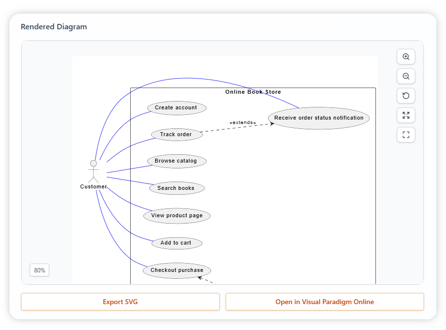

The Use Case Diagram: The High-Level Map
A Use Case Diagram is a visual, graphical representation that provides a high-level, “bird’s-eye” view of a system’s functionality. Its purpose is to show the relationships between actors (the external users or systems) and the use cases (the goals they are trying to achieve).
Think of the diagram as a table of contents for your system. It quickly answers two key questions:
  • Who uses the system? (The actors)
  • What can they do with it? (The use cases)
In the example above, a Customer can perform actions like Withdraw Cash, Check Balance, or Deposit Funds. The diagram shows the entire scope of the system’s external behavior at a glance, making it a powerful tool for initial stakeholder discussions and scope definition. However, it intentionally leaves out the details of how these actions are performed.

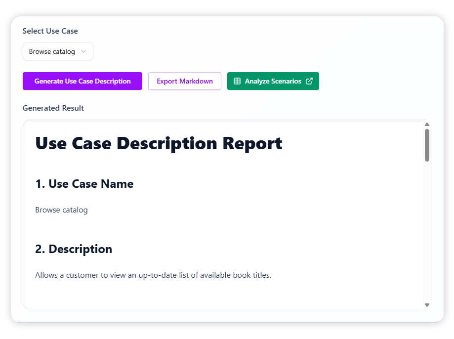

The Use Case Description: The Detailed Story
While the diagram provides the “what,” the Use Case Description provides the “how.” It is a detailed, text-based narrative that documents a single use case. It walks you through the step-by-step process of how an actor achieves their goal.
A professional Use Case Description typically includes:
  • Preconditions: What must be true before the use case can start (e.g., “The customer has inserted their ATM card.”).
  • Main Flow: The “happy path” or the step-by-step sequence of events for a successful outcome.
  • Alternative Flows: Other valid paths the actor might take (e.g., “The customer enters an incorrect PIN, and the system prompts for a re-entry.”).
  • Postconditions: What must be true after the use case is successfully completed (e.g., “The customer’s account balance has been updated.”).
This detailed report is crucial for developers who need to implement the exact behavior of the system and for quality assurance teams who need to test every possible scenario.
