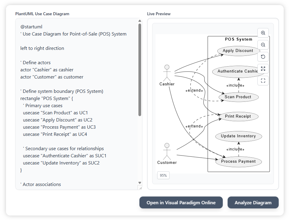

Step 1: Enter PlantUML of Use Case Diagram
Paste the PlantUML code of the POS use case diagram into the editor. The preview on the right will render instantly, showing the full flow of checkout and payment activities. From there, press the Analyze Diagram button to start refining the process.
PlantUML Example:
@startuml
' Use Case Diagram for Point-of-Sale (POS) System
left to right direction
' Define actors
actor "Cashier" as cashier
actor "Customer" as customer
' Define system boundary (POS System)
rectangle "POS System" {
' Primary use cases
usecase "Scan Product" as UC1
usecase "Apply Discount" as UC2
usecase "Process Payment" as UC3
usecase "Print Receipt" as UC4
' Secondary use cases for relationships
usecase "Authenticate Cashier" as SUC1
usecase "Update Inventory" as SUC2
' Actor associations
cashier --> UC1
cashier --> UC2
cashier --> UC3
cashier --> UC4
customer --> UC3
customer --> UC4
' Include relationships (mandatory)
UC1 .> SUC1 : <<include>>
UC3 .> SUC2 : <<include>>
' Extend relationships (optional)
UC2 .> UC1 : <<extend>>
UC4 .> UC3 : <<extend>>
@enduml

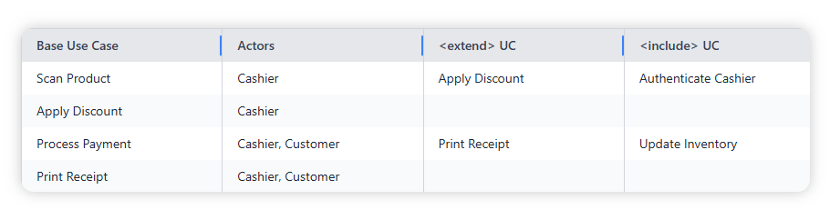

Step 2: Use Case Table
The tool automatically turns the POS use case diagram into a clean, structured table. This makes it easier to read through actors (cashier, customer, payment gateway), relationships, and the extend/include use cases without relying only on the diagram. It provides a simple way to validate that all steps of the payment flow are properly captured.

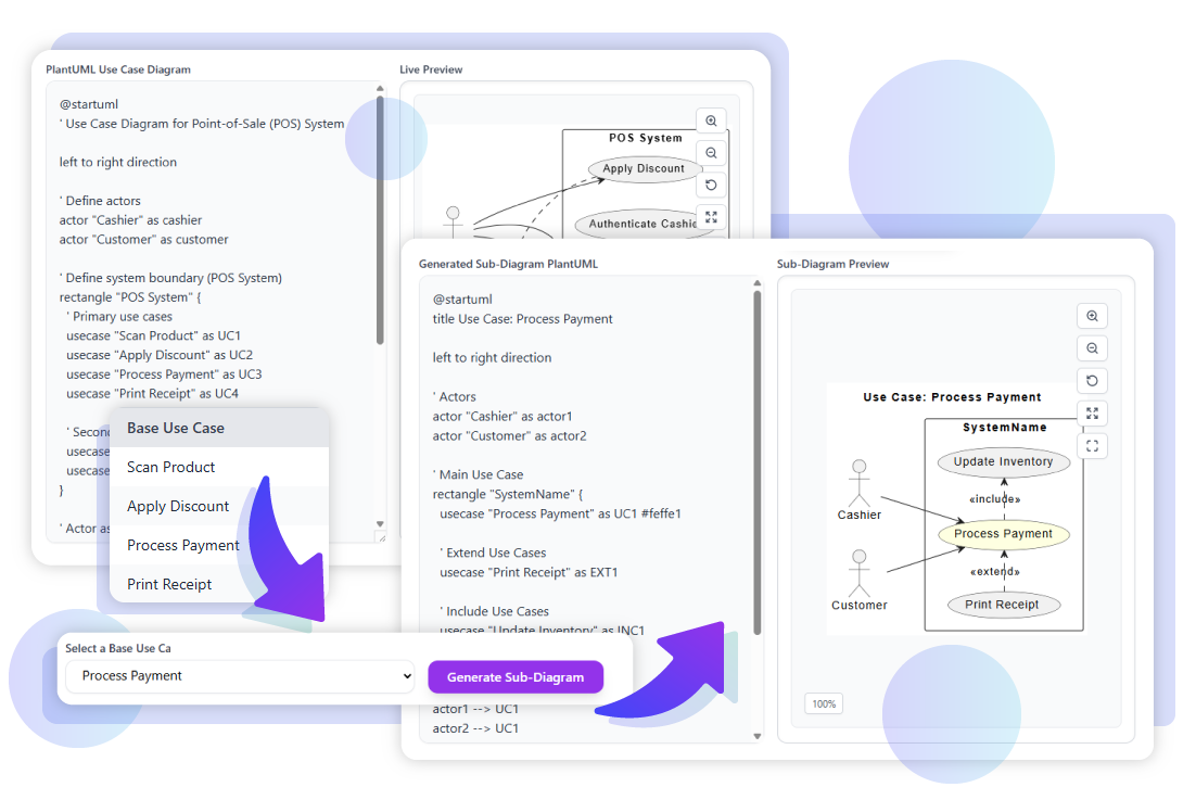

Step 3: Sub-Diagram Generator

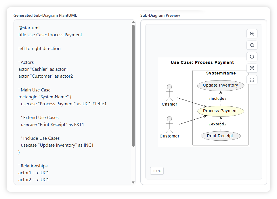

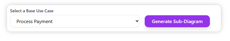

Select a Base Use Case
Choose Process Payment as the base use case. The tool extracts its include and extend relationships to form a smaller, focused diagram.
Generated Sub-Diagram
Click Generate Sub-Diagram to produce a simplified PlantUML diagram. The preview will update, showing only Process Payment, along with connected use cases like Print Receipt and Update Inventory.

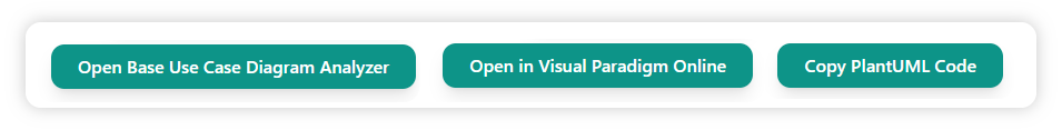

More Actions
Once the sub-diagram is generated, you can:
  • Copy Code – Reuse or adapt the PlantUML code for other scenarios.
  • Open in VP Online – Continue editing or styling directly in Visual Paradigm Online.
  • Download Image – Save the rendered sub-diagram as an image for reports, manuals, or training material.
